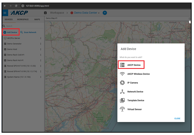

A. Add all your devices to APS and ensure that they are in a reachable status.

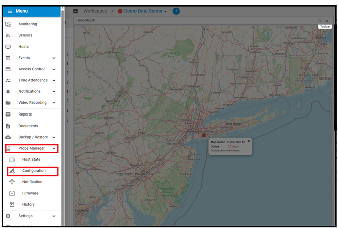

B. In the APS menu, go to probeManager, then select the Configuration option.

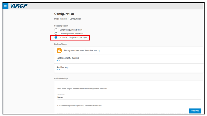

C. From the Configuration page, select “Schedule Configuration Backups.”
D. Then configure the following settings:
1. Select how frequently configuration backups should be created:
– Options include Never, Yearly, Monthly, or Daily.
2. Choose a configuration repository to save the backups:
– Click the “Browse” button and select the desired drive and folder location for storing the backup files.
3. Set up the Email Report SMTP server settings:
Click “Edit” to be redirected to the SMTP Email Alert page, then configure all the required parameters.
4. Enter the email addresses to send the backup report to.
– A notification email will be sent when the backup has been successfully completed.
5. Click the “Add Host” button to select multiple SP+ devices from which to obtain backup files.
6. Then, click the “Save” button to apply and save all settings.
