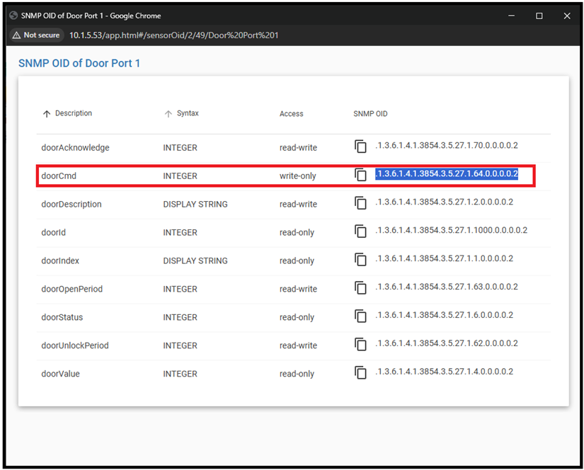

We are want to use the SNMP set command to open or close the AKCP Swing Handle Lock (SHL) using third party software by one of my customer but the set command is refused.
Please support.

It is possible to control the SHL (AKCP Swing Handle Lock) using SNMP Set from your 3rd party software.
Here’s the procedure for Swing handle lock control using SNMP Set.
Step 1: Go to the Sensor page.
Step 2: Click on the Handle Lock Door.
Step 3: Click GET SNMP OID in the top-left corner. A new window will show the OID for Door Port 1. Image below for guide.
Step 4: Copy this OID: .1.3.6.1.4.1.3854.3.5.27.1.64.0.0.0.0.2, Image below for guide.
Step 5: Paste it into your SNMPSET tool (tested using MID Browser).
Step 6: Set the Data Type to UnsignedInteger.
Step 7: Enter the value: 1 = Cycle Unlock 2 = Lock Door
