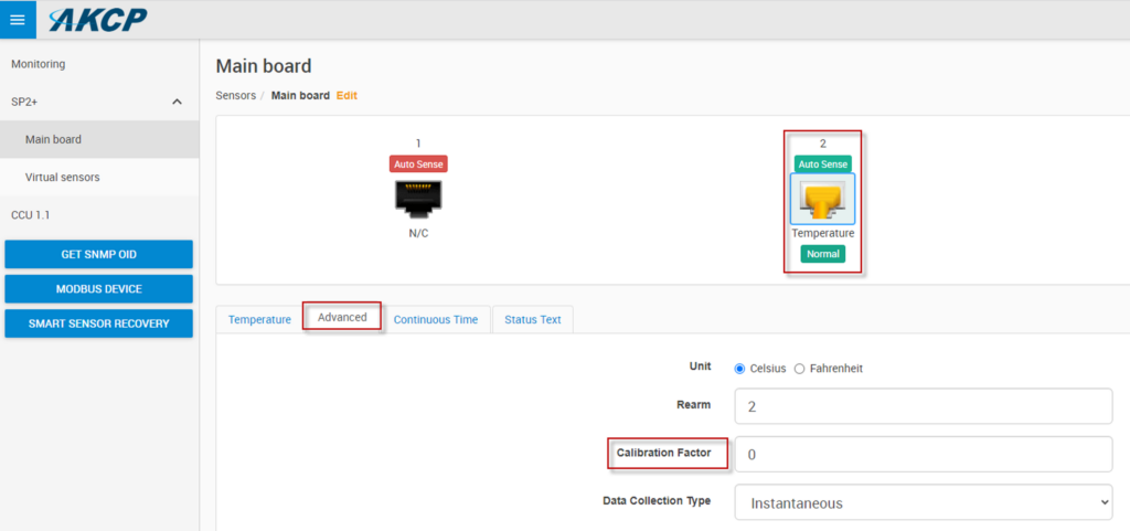

To adjust the AKCP sensor readings using the web interface, we provide the “Reading Offset” feature in the AKCP securityProbe base unit as shown in this screen shot below. Simply log in to the web UI as the administrator, then navigate to the Sensors tab >> Click on the sensor’s icon >> Advanced tab then adjust the Reading Offset as explained in the example below.
The “Reading Offset” value will be added to the sensor reading value.
For example, if a reference temperature sensor is reading 19.8 C and our AKCP THS is reading 21.7 C the n a offset of 19.8 – 21.7 = -1.9 C should be used.
After saving the offset value -1.9 C, the device will automatically subtract 1.9 C from the future readings of the THS. So, the new readings will be 21.7 – 1.9 = 19.8 C.
If our sensor is reading lower than the reference sensor then you would need to add the positive value for the offset.
For the AKCP SP+ base units, follow the same instructions above only in the Advanced page you would adjust the Calibration Factor as shown in the screen shot below using the same parameters as explained in the example above.
