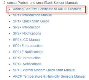

Referring to our manual that is located on our website support portal here;
The HTTPS port on the units and APS is always enabled. You can change its listening port, if necessary. On the SP+ family, the HTTPS supports TLS v1.1 and v1.2.
The HTTPS cypher suites are not customizable.
To eliminate browser warnings about the self-signed SSL certificate, you‟ll need to replace it.
Using the “Upload Certificate File” option you can upload an SSL certificate that will be used by the unit‟s or APS Web UI for HTTPS connections.
Your will need to upload this certificate file as a .pem file which is explained in detail in our manual highlighted above and exactly how to create this file. The manual includes all of the other details and steps.
