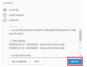

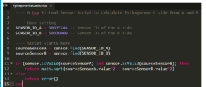

In this example, I created a Virtual Sensor “VS 19 Find C Using Pythagorean” using the script I attached.
The script calculates the C side using Pythagorean from the length of the A and B sides from sensors on the SP+ (Can be configured in the “User setting” section of the script).
Note : The Sensor ID can be found in the last part of the browser’s URL of the sensor setting page.
To create Vitual Sensor Lua Script, do the following.
Go to Sensors => Virtual Sensors => Select an empty Virtual Sensor slot
Sensor Type => Lua Script Sensor => Next => Import => Browse to the attached PythagoreanCalculation.lua then follow the Virtual Sensor wizard.
