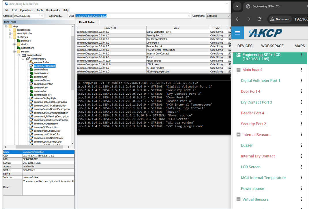

Thank you very much for the question on this. The best way to export the sensor compound OID would be to use the commonDescription OID (.1.3.6.1.4.1.3854.3.5.1.1.2).
You can use the “Get Subtree” operation from the iReasoning MIB Browser or do an snmpwalk to the OID, which will list all sensor descriptions as shown in the screenshot below.
snmpwalk -v1 -c public 192.168.1.185 .1.3.6.1.4.1.3854.3.5.1.1.2
You can then copy the last 5 digits (compound OID) from the results to the map with the sensor description.
