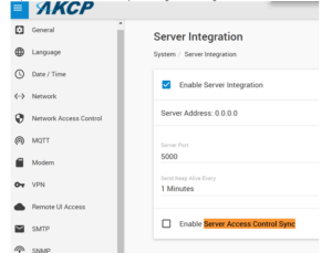

1) Disable the “Server Access Control Sync” in Settings => Server Integration.

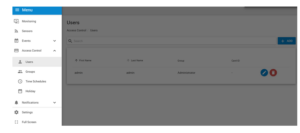

2) Go to the Access Control pages and configure the users and access permissions, schedules.
The concept is the same as the APS Access Control so you can check the “Card and User management” section (page 25-44) of our SHL manual on our support portal.
