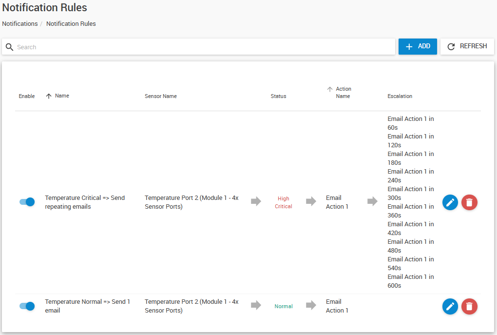

We don’t have forever repeated notifications until the problem is resolved. However, you can use the “Notification Escalation” feature to achieve similar behavior.
Please see our setup example below. When the status changes to critical, it will send 1 Email. Then send an Email every minute for 10 minutes, until the status is changed or acknowledged from the summary page. When the status changes to normal, it will send 1 Email.
You can also apply the escalation feature to the SMS alerts as well.
