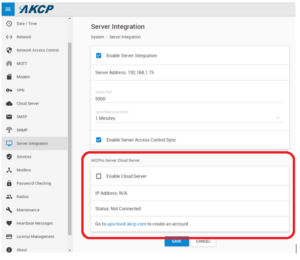

A: You should be able to proceed directly to the apscloud.akcp.com page and create an account, then sign in to your new account and add your device via its MAC ID. This new cloud account is free for up to 4 devices for a year. You will need to turn on the server integration and enable the APS cloud in the SP+ web UI (see below for a screenshot of this option).

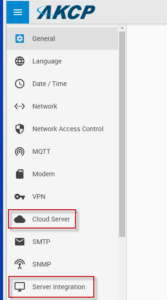

If you have enabled it, make sure that you disable the “Cloud Server” option and reboot the unit.
This is for another feature, the Cloud WebUI that allows you to access the unit’s web interface from anywhere, similar to doing a port forwarding on your home router (as explained above).
The cloud APS connection will not work with this enabled, as both options are using VPN technology, and only 1 can be active at a time.
For using AKCPro Server CLOUD the correct option to use is here, under Server Integration:
