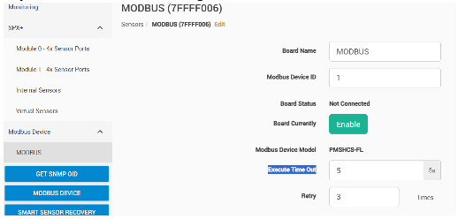

3. Adjust the PMS Modbus Settings: Set the Execution Timeout to 5 seconds and Retries to 3 as shown below in the SPX+ web UI.

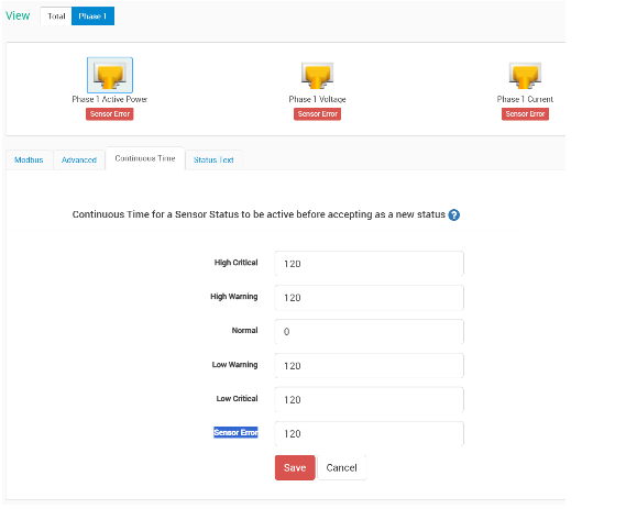

4. Adjust Continuous Time: Since the polling interval is 15 seconds, we suggest setting the Continuous Time for the Sensor Error status to 120 seconds. This allows the SPX+ to retry communication multiple times and only trigger an “Error” status if the failure persists for more than 2 minutes. Please reconfigure this for all sensors on the PMS as shown below in the SPX+ web UI.
