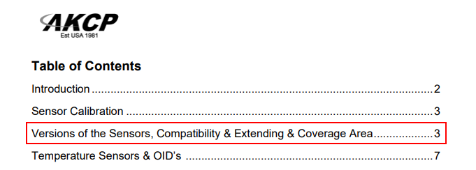

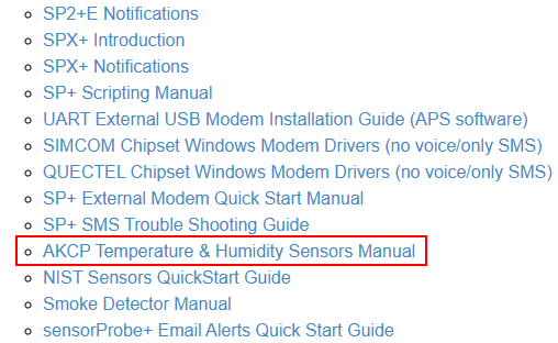

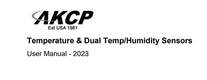

Thank you for your question on this. All of the details regarding our recommended coverage area regarding the temperature/humidity sensors are covered in our THS manual that are posted on our website support portal here;
